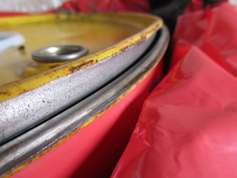

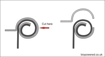

Drum lid removal
A novel idea from littledave. Slice through a drum seam with a 1mm cutting disk on an angle grinder and you have a removable lid. Dave recommends marking the lid and drum so the lid can be replaced in the same position each time. Not all drums will be perfectly circular and the position of the cut may not be in the same place around the circumference.
- Drum seam cutting
Bio-rich-time-poor 23:15, 27 June 2011 (BST)

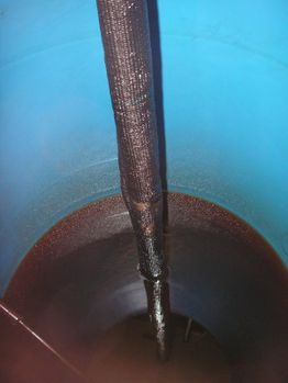

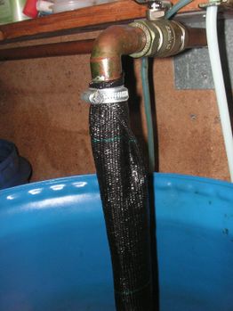

Mini sock filter to prevent sediment agitation
When pumping from the processor to a settling tank, simply dropping the biodiesel in from a height can stir up sediment and soap that’s already settled. To prevent this a small diameter sock filter can be sewn from landscaping fabric.
The aim is not so much to filter the biodiesel, as the fabric is a very course weave, but to allow the incoming biodiesel to be added gently to the tank. It was found that the bio was aerated using a peripheral pump, so a weight can be fixed to the end to prevent the sock from floating to the surface. Best results are obtained if the sock extends into the bio which remains at the bottom of the tank.
- "Mini
Julian(talk) 08:19, 26 October 2013 (PDT)

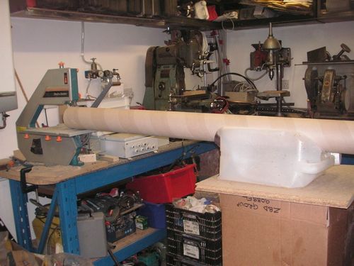

Empty cubie helps cutting carpet cores for glogs
The writer uses a band saw to cut carpet cores to 8" lengths for glogs. In long lengths, these can be a little unwieldy when trying to balance them on a small saw table.
A suitable stack of boxes etc topped with an empty cubie solves the problem. The cubie lid is loosened and the core pushed into the cubie to form a guide. The lid can then be tightened to retain the shape and height. The core is now supported at the right height, won't roll off the table and is easily slid and rotated on the cubie.
The idea needn't be limited to carpet cores, the idea should work for many other items and profiles being worked on various machines.
Julian (talk) 11:48, 6 April 2014 (PDT)
